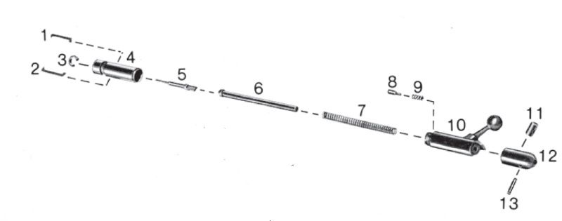

Below are the parts relating to the bolt. The image is from the 1975 Anschutz parts list for the 1403.
As can be seen a spring (shown as part #7) is needed.
If this is the spring you are referring to, you need it. Otherwise the firing pin will flop around in the bolt head and not retract when the bolt is cocked.
Look in the bolt head , it may still be there. Sometimes the spring will stick in the bolt head and need tapping out.

The firing pin in your Attachment looks different than the firing pin in my Anschutz 1403. MY Anschutz 1403 much be an earlier model? The firing pin spring I’m referring to is shown in front of part 5 (if that’s a springs?)

Yes, the small spring in front of part # 5 is what I was referring to. The picture I posted is from a model 64 Anschutz but I think the spring is the same.
The 1402 takes the same firing pin spring as a model 64. Midwest Gun Supply has it for $5.
