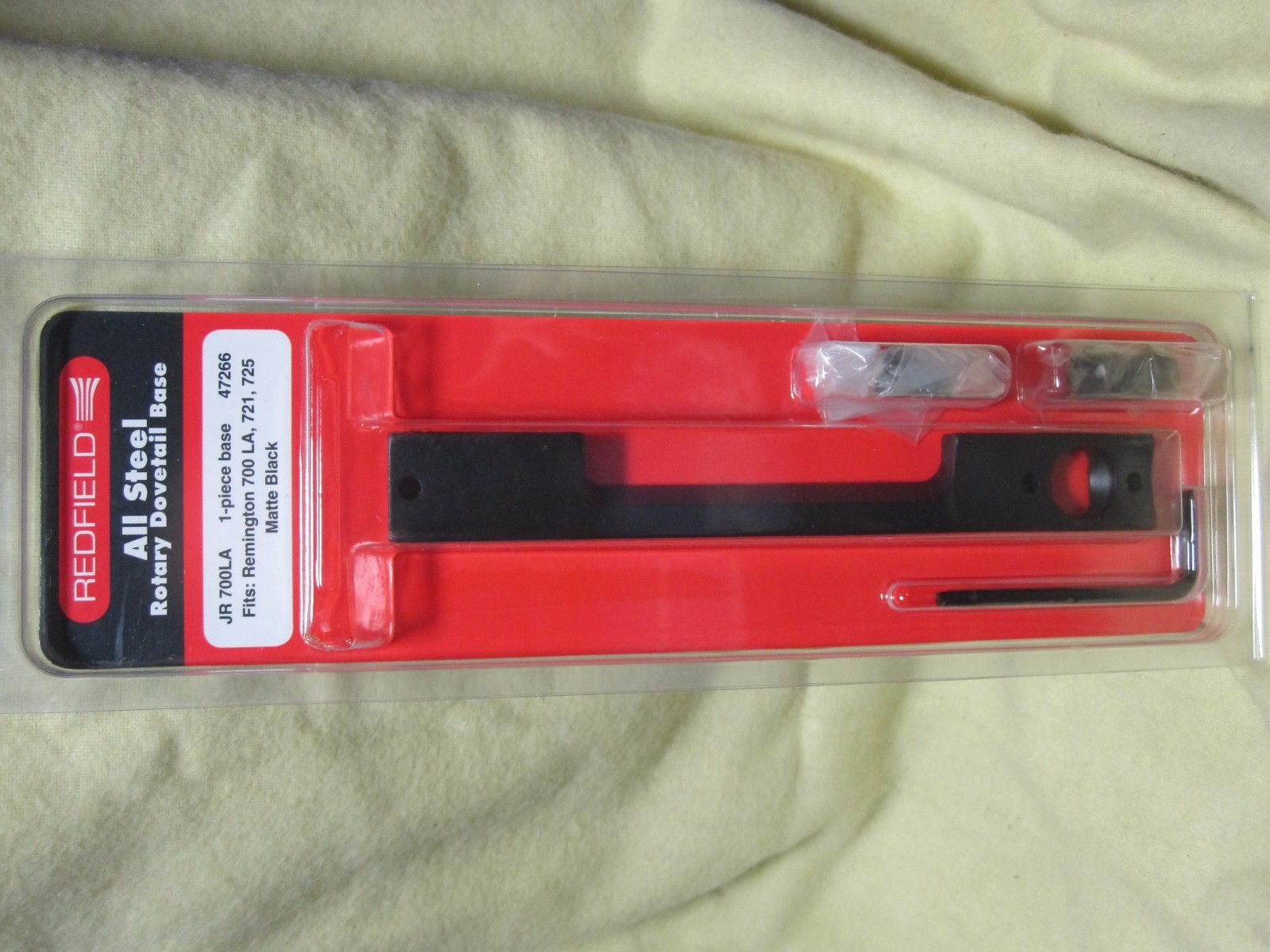

so If you could spec out a pair of bases for round top m77 ill appreciate your advise
I apologize . I'm getting conflicting data on the bases . I've been digging thru stacks of books trying to find the old Redfield shop guide . What the oldest (1977) I can find just lists 2 piece bases 79 rear and 35 front which is dif than a Rem 700 (36 rear 35 front ) but 1990 ish books show what you pulled up , the Redfield jr base as being the same for Ruger round top mag length and Rem 700 la . IF that is correct ,than any one piece picatanny or weaver SHOULD fit . Weigand shows a 20 moa one pice rail .

your right I found redfield chart and its a 47266 matt finish but what am I looking at I have no idea how this works can you advise how and what needs to be done to install this

If the Rem 700 la one piece fits , let me know . This Redfield was the standard most others copied . It allowed the scope to be zeroed using the WINDAGE adjusting rear screws and left all the windage still in the scope .
The blued steel was preferred by some to match the high gloss blued finishes of the day , the windage adjustable bases were useful in some questionable machine work and the conversion of military rifles .

Looked on 2009 REDFIELD scope and base catalog which shows Ruger round top long action and 700 Rem. same base JR SR
after some searching I have an understanding how dove tail rings mount , Not sure about rear windage mounted seems problematic rather install F.R. dove tails or weaver style 2 piece.
serial # tells me rifle was built between 72 -73 so i think this falls into M77ST or round top . I have a standard 700 rem picatinny one piece and Leupold which now owns Redfield markets
Leupold 49841, QRW/PRW Scope Base, Remington 700, Matte Finish.
Which looks good
This coming weekend I will post what works and what doesnt.

So i got around to modifing a 20 moa pic. Rail Rem.700 LA.
Could only use three screws , also needed to shorten rear so bolt will have clearance
