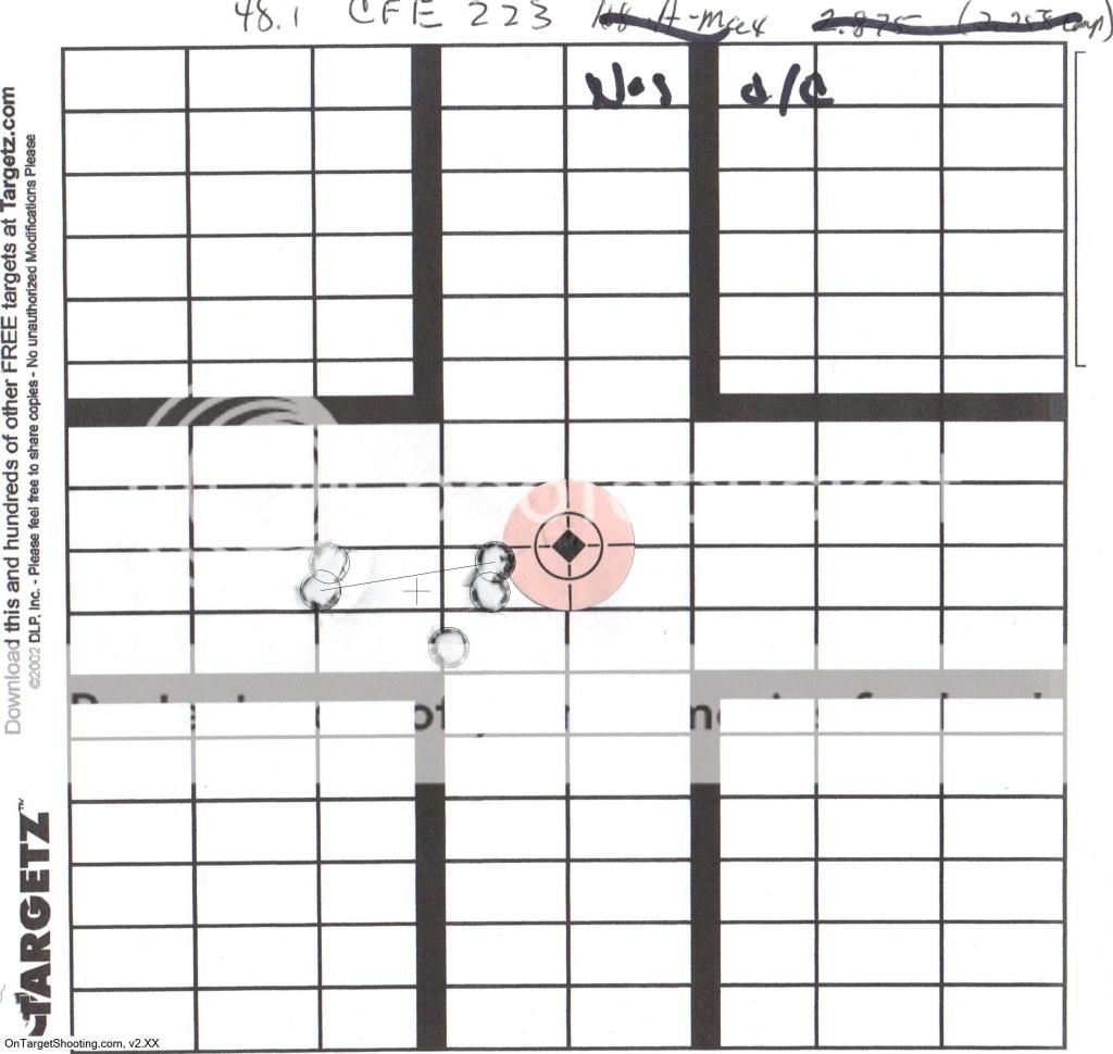

To support what I believe to be good results, here is a target from Monday morning at the range. Conditions were less than optimal with winds varying from 5-12 mph and "squirrelier than Nancy Pelosi"
The rifle was a Remington 5R Milspec with B&C A-5 stock, Sinclair Tactical Bipod, and a rear sandbag that was lying around the range (I forget my good one at home)
The load was a
Winchester Case neck sized only,
48.1 gr of CFE223,
Nosler Custom Competition BTHP,
Wolf LR primer.
2.820" OAL.
Chronographed at 2737 fps avg.
The group consists of 5 shots, range 100 yards.
ry%3D400
I do believe if I had done a better job reading the wind, had no wind flags up, the shot on the left and shot on the right would have joined the three in the middle. Using "On Target" the group height measured .104" and width .867" With an "Average To Center" (of group) measurement of .207".
Monday's range session was to confirm the results I got the previous Monday. If I hadn't said it before, I will again. I like the speed potential for this powder in my loadings as well as the lack of "crunch" I get when loading Varget and get speeds about 100 fps slower with this bullet.

amelivivn,,,you are there!!! ,,,less than 1/2 bullet vertical,,,,the left and rt. is as you say from the wind and no flags.....when you see the bullets sittin like birds on a wire,,,you are there...there is nuthn wrong with your load....this is showing us what this powder will do .....and you have your stuff working right...Roger
PS,,,is that jumping or jammed!!???
Would you believe me if I also told you that this is from a rifle with close to 4,000 rounds "down the tube"?
It's the stock factory barrel that Remington puts on their 5-R's that are hammer rifled. I'm afraid to change it as it shoots so darn good 8)

just curious,,were you jumping or jamming the bullets,,,Roger
In a Remington 5R Milspec you need to ask? :D :D :D For some reason Remington decided that a freebore almost as long as the cartridge itself was necessary. To jamb I have to load 175 gr Noslers at almost 3.000" >:( Strangely enough, when loading 175gr Nos Custom Comp's to 2.800" I get the best performance from this rifle. Even better than above.

Amlevin: What grain bullet was used in the posted group?
A 168 gr Nosler Custom Competition BTHP. Like the SMK's this bullet is less sensitive to "jump" and is available for less than a quarter each when buying in boxes of 1,000. At least a dime less than the SMK's.

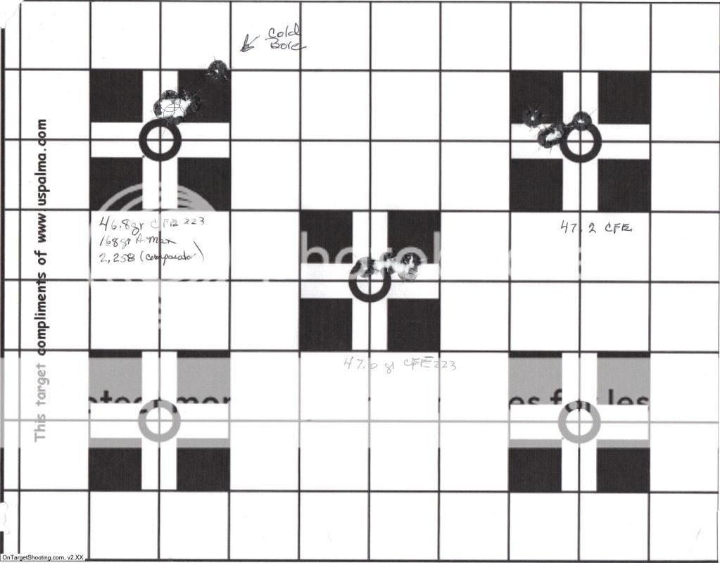

Yesterday I took decided to see if the results at 100 yards would translate to 300 yards with the same old "Factory" rifle.
I sure would have appreciated less wind but it is fall and it will be a rare day to go to this range and have any calm days until next summer. wind was 4-8 mph and again coming from all four directions at one time or another.
Maybe not a group of "bench rest quality" but at least under 1/2 MOA.
Group width was 1.304'(.405 MOA) with a vertical dispersion of .639 (.204 MOA).
Bullet again was a Nosler Custom Competition using 48.1 gr CFE 223 in a Winchester case at 2,820 OAL (about the max for magazine feed from my rifle).
300 yards ( really need to get some wind flags ::))
Also decided to play around with some 168 gr A-max and it looks like my 'starting' load' will be my regular load.
The upper right shot was on a totally clean bore, no foulers. The next four all got nice and snuggled up :)
If this powder is slower than Varget or RL-15, it just might be the ticket for the 185's. FroggyOne2 is thinking on the same lines as I am on this one. Wouldn't it be great that there is an easy metering fine ball powder that could push the heavies to good velocities for 1K shooting without giving up all the brass life to get the speed? I'm looking forward to doing some testing myself in my 30" tube rifle ASAP.
