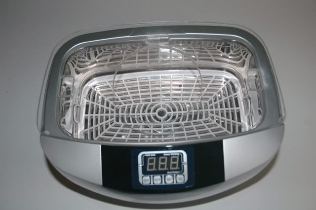

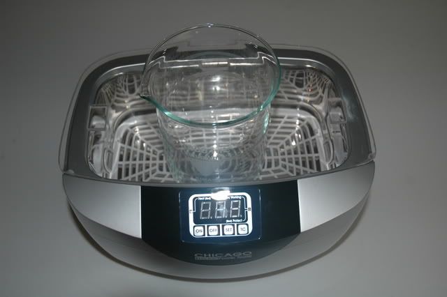

I bought a cleaner from Harbor freight and made a new top to hold the beaker.
I use a very simple solution in mine. 75% water from my RO drinking water system, about 20% white vinegar and a few drops of dish washing detergent, I also have found that a 1/2 teaspoon of "Limishine" helps with the shine, kind of a dull looking case without it. I can clean about 40 cases before changing the solution. I clean for 480 seconds, rinse with RO water and blow dry with compressed air. This will normally clean 100% inside and out.

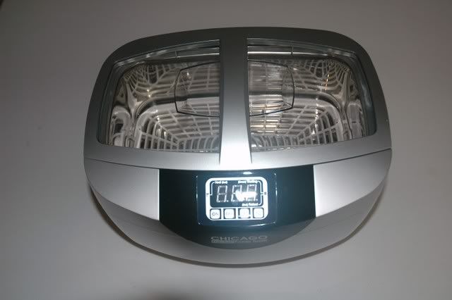

Cleaner with nothing done to it
Cleaner with new top

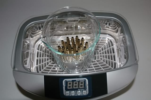

With beaker installed
With cases in beaker
