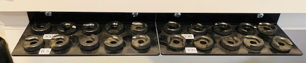

I solved that problem (for my press) with the Redding Competition Shell Holder set ... where I set the die height with the .010 holder for slight cam-over, and then reduced the shell holder size until the shoulder bumped perfectly. Most work great using the .004 shell holder and give me a great 2/1000-ish bump. A set for each caliber I reload was a great investment ... and I use the shell holder rack from Inline Fab to keep them organized. Remember ... it's not a "problem" if you can solve it with money - it's an "expense". LOL
