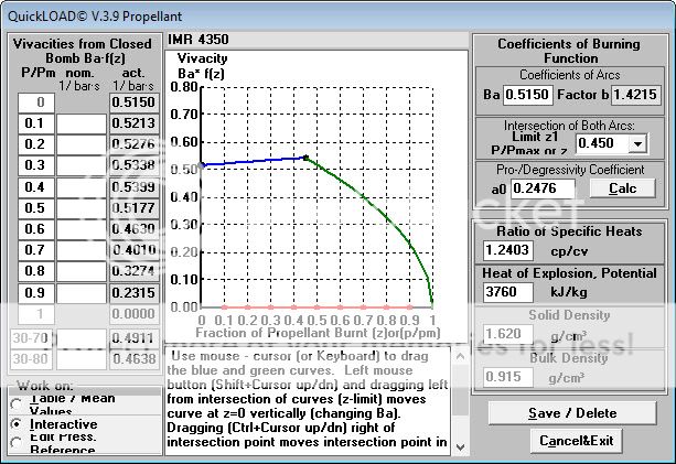

Thanks. Any idea on how to adjust the burn rate so I can make what FPS I am getting to match quickload?
You can change the burn coeficient (Ba) by selecting it in the powder menu box and manually input the value you desire. I don't have the program with me ATM but if you pull down the help menu it will describe the process.
To the left of the powder there is a box with a hand holding a pencil, hit that and you'll be able to adjust the rest of the parameters. Then Adjust the burn rate Factor BA up or down.
I read that adjusting the Weighting Factor also works, which of course it does indeed change the pressure and velocity outputs, but I don't know for a fact if this way is acceptable.

I would have thought that IMR 4350 would be too slow for a 308 win. But Quickload show it as appropriate with a 230 grain bullet. Watch out for the barrel length, cross section area, case capacity. They are what I shoot. I let the program default on seating depth. But still it shows the Z1 on top or close to the Pmax.
http://i689.photobucket.com/albums/vv253/brantfredrickson/2016-08-08_IMR4350 Berger 230 Hybrid 308Win_1.jpg
<a href="http://s689.photobucket.com/user/brantfredrickson/media/2016-08-08_IMR4350 Berger 230 Hybrid 308Win_1.jpg.html" target="_blank"><img src="http://i689.photobucket.com/albums/vv253/brantfredrickson/2016-08-08_IMR4350 Berger 230 Hybrid 308Win_1.jpg" border="0" alt=" photo 2016-08-08_IMR4350 Berger 230 Hybrid 308Win_1.jpg"/></a>
