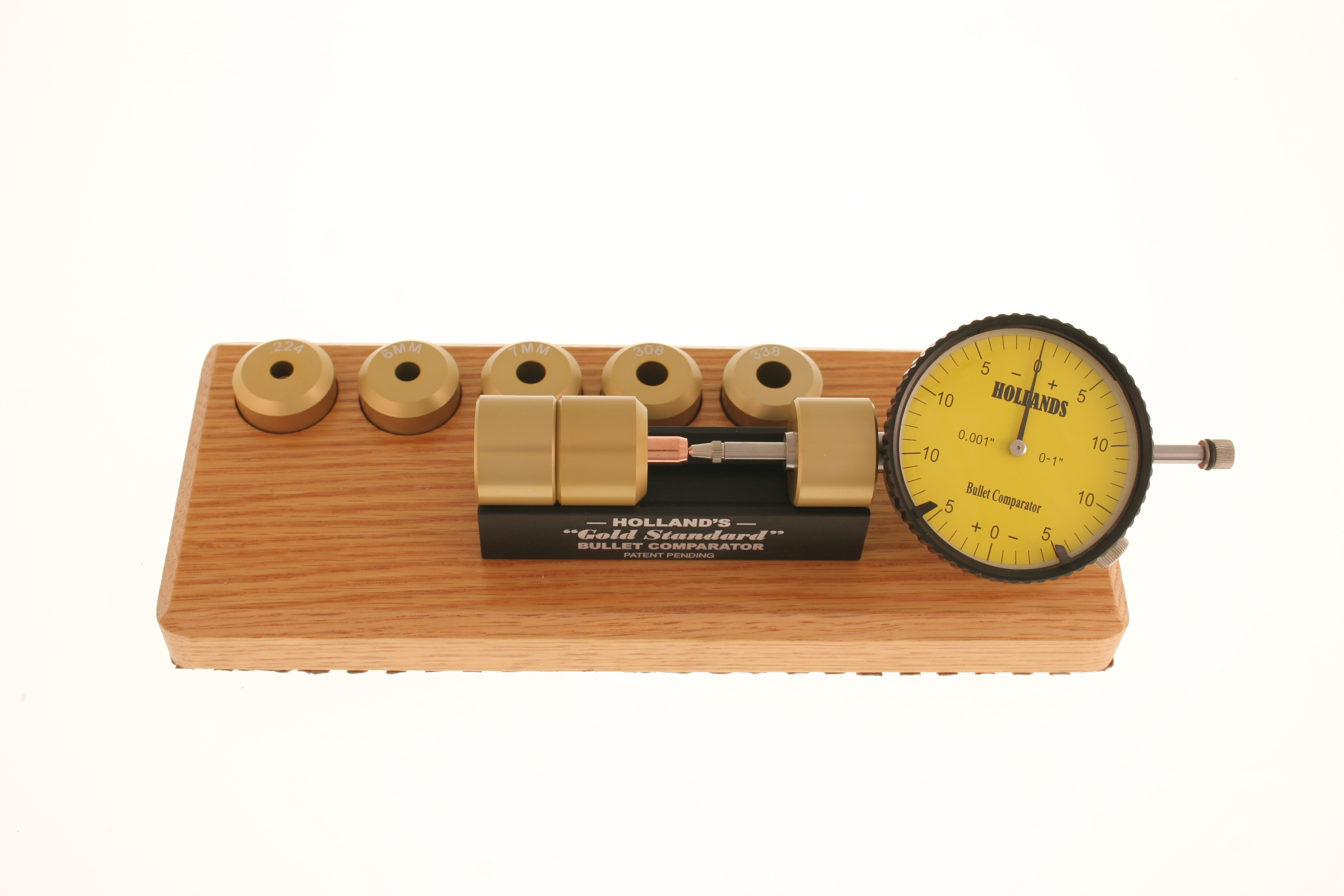

You can measure the actual bullets and get more than 0.005 variance. The way the jacket tip forms when they are made will cause length to vary. Whether that matters or not is another subject. Cartridge overall length is pretty meaningless unless you have a limit, as mentioned above.
You need to measure the length from case base to the bullet ogive or where it would contact the rifling in your chamber to know if you have a problem.
OAL will vary with any reloading set-up. Bullet lengths vary so that cannot be remedied. Ogive measurements will be much more consistent.
EDIT: Actually when you vary the seating depth by COAL it is changing the distance the ogive is positioned from the lands causing varying numbers there which in turn will be detrimental to accuracy.

Does your seating die have the VLD seating stem?
Yes, I purchased it separately from the die maker. Thanks
But not all bullets are the same, I'd pull my seater stem and see if it's making full contact to bullet or wiggling, if it wiggles 1 iota I'd say that's the problem.
I can seat bullets out of various sorts of same bullet and be with .001 on depth, the few thousands difference just gets pushed deeper into case.
FWIW I sort bullet OAL
