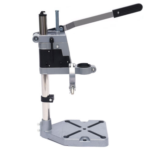

My first seating press was a converted bottle capper. I've also made a couple for local guys from cheapy ebay drill stands.
