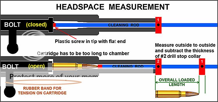

I use a similar method. I bought some drill depth stops and use them on a cleaning rod that is close to the bore diameter. I also got a kit several year ago that had some flat tip screw in plugs for the cleaning rod but they also had some flimsy plastic stops that I don't like to use. On a bolt gun, I sometimes use a rubber band just strong enough to keep the bolt against the case and the case in the chamber.
Close the bolt and run the rod in until it touches and make sure it's not on the ejector pin. Run the (#1) stop up against the muzzle and lock it. You need to make a dummy bullet that is seated too long to chamber. Lightly run it into the chamber until you feel it touch. Now add the second drill stop on the cleaning rod, then insert and lock it in place when it lightly touches the bullet tip. The headspace/COL is the distance is from outside to outside the drill stops minus the thickness of the last one (#2 here). By being careful, I can repeat measurements to .001". This will work on one exact bullet and sometimes only with one lot number. You can now seat the bullet to the same overall length you measured and take your measurements from there. Maybe use the Hornady bullet insert/comparator to get a reading and then subtract what ever jump you want to have. Keep in mind, the overall length of the bullets can vary several thousandths even in the same lot. It takes a light touch not to jam the bullet into the rifling or to move the bolt backwards when the dummy round is in the chamber. Sometimes I use my finger instead of the bolt so I can feel when the rod makes contact. If you use another rod (aluminum would probably be best) instead of a cleaning rod, you won't need to plug the threaded end.
