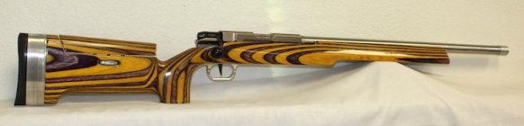

They shoot a lot of 200 yard 22 F-Class prone here close to home...how serious and what kind of guns? Here is a picture of a friend of mines gun...had an exact copy of his F-Class rifle built using a Anschutz 2000 22 action...
I'm building mine on a 40X to be exactly like my PR&T stocked F-TR rifles right down to the Jewel triggers and the Nightforce scope.
