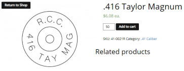

Before Norma started making these cases, we simply necked down .458 Win. Mag. brass for fireforming. Usually any of the larger caliber 2.500" belted magnum cases can be adjusted to work. We used the same idea when making .458 Lott brass except with the 2.800" brass.
As pointed out above though, if you need the proper headstamp then you will need to go to Quality Cartridge or RCC if Norma doesn't get up to speed shortly.
RCC:
