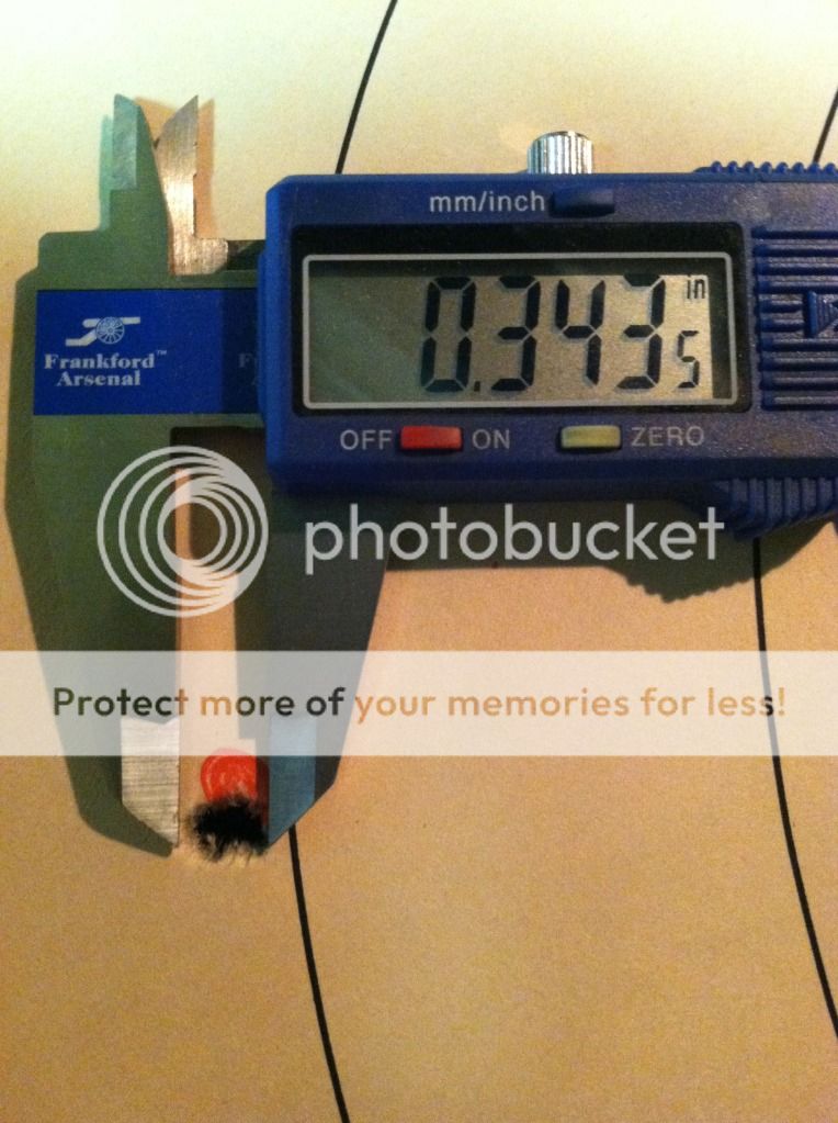

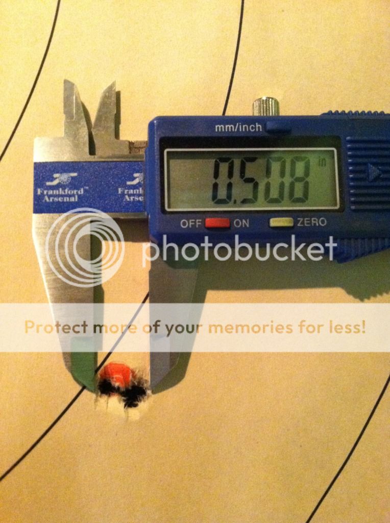

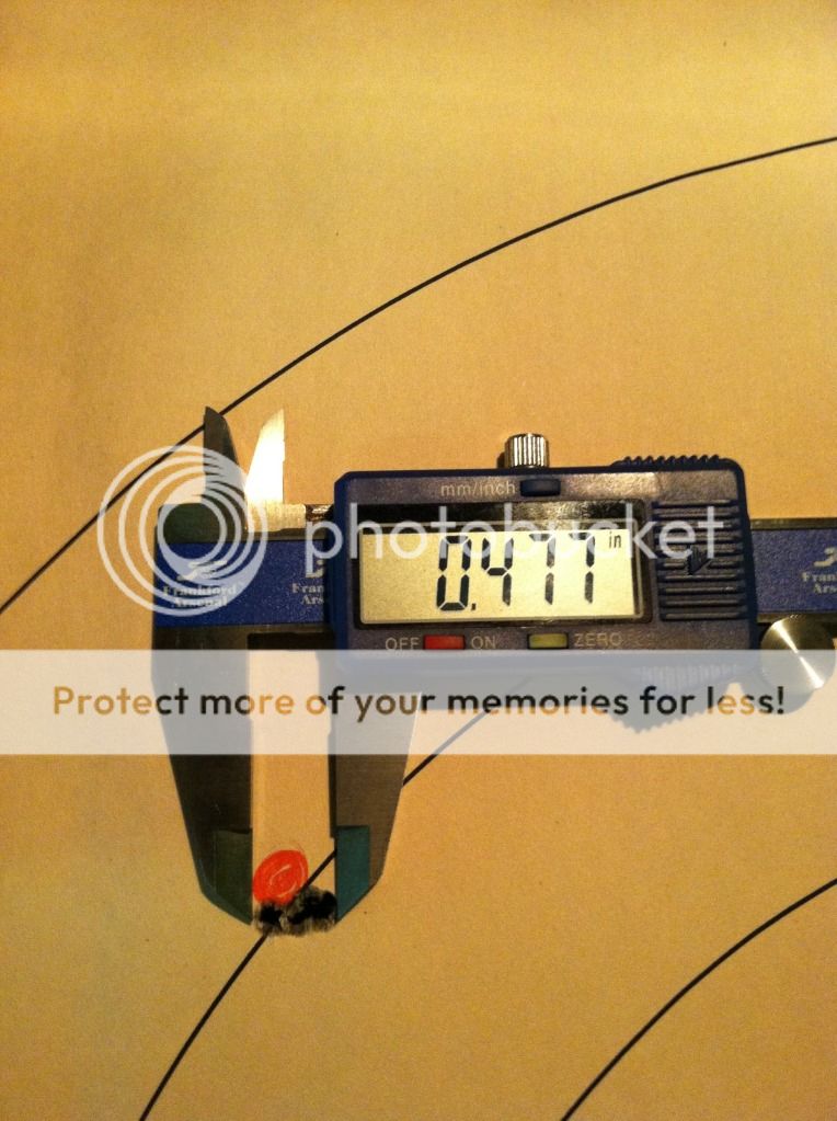

I necked down 40 pieces and used a .2415 inside neck reamer to remove the very little that was there. I then did 40 pieces where I did not use the inside neck reamer. I only got a chance to shoot half of each yesterday, as it was raining, and the range was closed due to lightning.
I did this - net .1005 @ 100 yards with the reamed neck
And this as well
These were the 2 best groups with no reaming.
I doubt there was any long term significance to the neck reaming, but nice to see a small hole none the less.
