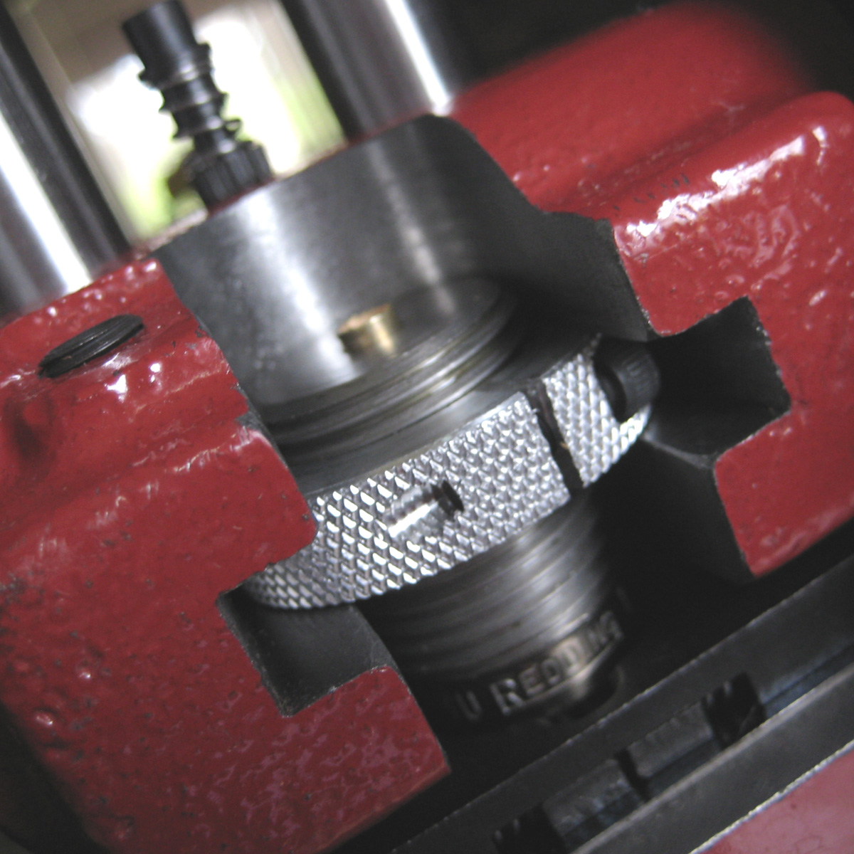

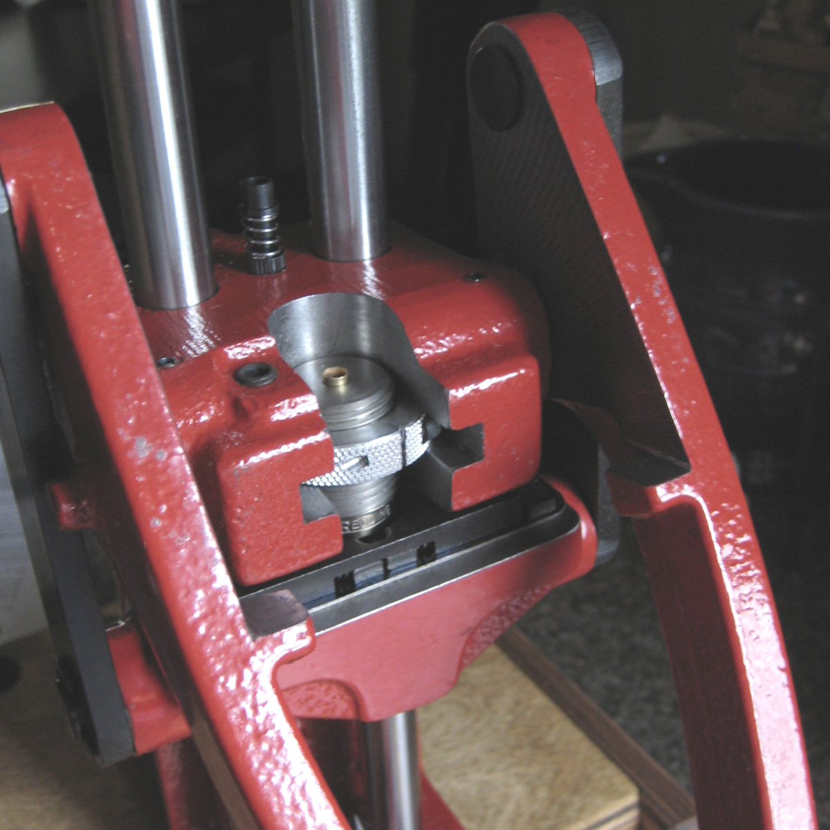

No trimming with Forster Co-Ax??
The Forster Co-Ax and a trim die are new to my reloading experiences.
Do the trim dies and the Forster Co-Ax not play well together or do I have other options?
Getting the full stroke of a file is impossible with how I have the die set up.
Thanks for any input if I'm missing something.
No way round that.
If you have to use trim dies, I suggest that you buy any inexpensive (new or used) conventional C press that carries the die at the top & use that.
Even if it did work I doubt that you would like brass particles all over your press mechanism.

Steve Blair, when forming cases with a trim/form die the case protrudes through the top of the diel. the protruding neck must be trimmed. There are three ways to trim the neck; I use a hack saw then finish with a file. then there is the air craft countersink. The air craft counter can be used to flair the protruding neck, the faired neck will pop off when the ram is lowered. If you scroll up at the large pictures you will notice the die is countersunk above the press meaning it is not possible to use a hack saw or file. I do not have the Co-Ax but if I did I would use an aircraft counter sink operated by an electric drill.

I agree with Frank, the OP was kind enough to furnish a large picture that did an excellent job of demonstrating the problem. By design he can not trim the protruding case from the top of the die because the top of the die is below the top of the press; meaning a hack saw and file would be awkward to use. Again, that leaves the aircraft countersink. Then there comes the 'more than one way to trim a case', I have the Dillon 1200 and Gracey.

Back to the pictures furnished by the OP; the trim die he is using is a short trim die. If the trim die was taller it could protrude high enough to use a hack saw and or file or both but then there is the limited room. I supposed little bitty hack saws and little bitty files could be used. I have handles for hack saws and files that are used with limited space.

It does not prevent forming, it complicates trimming

The best option may be a separate press, such as the C press as suggested. This will prevent the shavings from piling up on the Forster as an added bonus.

I have no fewer than 20 presses; I do not have a single stage press with an obstruction above a die. That clears the way for the hack saw and file. I have no fewer than 200 aircraft countersinks of different sizes. I would not recommend the CO-Ax as a first and or only press. Again, a tool could be made for the Co-Ax for trimming, the tool could be similar to the tool I have for making gages. The tool is a pivoting ‘V’ block that is used for butt grinding.

I don't think that there is any simple, efficient method to be able to trim cases in a Co-Ax. As stated, no one press will do everything, or everything well. A cheap O or C press, as mentioned, is an option. I don't want to do any trimming on a press, so I don't. I would not want to do it on a second press. I use trimmers for that. You can case form on a Co-Ax. I just don't know if I would want to do what could be heavy work on a Co-Ax when I have Lee Classic Cast that can do it. I would probably save the Co-Ax for most of the conventional, precision tasks.
I suppose that if you have to get the trimming done on the Co-Ax, you can, with some kind of tools that you can go at it from above, but it may take a long time and you might risk running a tool into the press.
