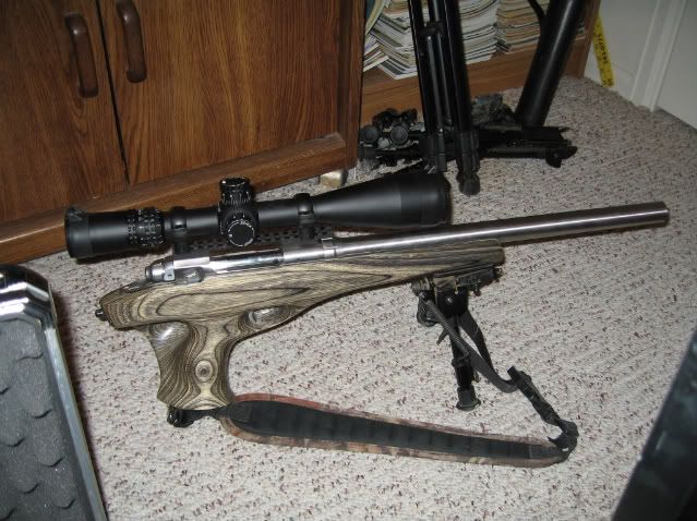

Hey Preacher, you should've been at the www.moaguns.com long-range shooting match we just had in Sundance, WY. Lots of prizes and events at the match this year. Wish i could've been competitive at the roving field course with this rig--
22-250/15" McGowen/65 JLK Low Drag at 3230 mv. I have the NP-R1 in it and love it. Had this rig's drop chart down pat but on the 1st tgt. the trigger failed on me due to some stock work i'd performed recently, that may have caused a problem with the trigger. Shoots well though at ~0.5-0.75.
