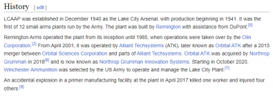

Went to work for dupont in 82. Good outfit to work for. Olin got the contract around 85 and started cutting jobs and piling more work on you so they could make more money. Never was a big winchester fan. For a boss. The old L.C. stuff before 85 probably got checked more. They make it different now anyway. May be excellent I dont know. Doug
