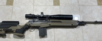

I just got some of the Sierra 2277 177 Matchking closed nose. I’m going to get working on a load. The BC is .545. They look identical to the 2156 155 Palma except the bearing surface is longer. They measure 1.320. Here’s my M1A.
