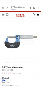

You don't need a ball micrometer. Use a feeler gauge to get the neck turner mandrel to cutter gap close, then turn a case. Seat a bullet and measure the OD of the case neck. That's the only dimension that really matters. I've been turning .17 Mach IV cases for 30 years and have never measured neck wall thickness directly.
I use the Starrett Tube Mic for quick checks, had the the Tube Mic Ken (K&M) sold but had constant back lash in the threads so got rid of it. Now I personally seat a bullet and measure with a Starrett V-Mic at several points. I find I get a more consistent measurement. I also have multiple K&M neck turners which I leave set up per calibers to save changing. A good feeler ga is very handy to spot check the clearance when doing a lot of cases. The cone washer that tighten the cutter on the K&M can loose tension from age. I once chased my tail for hours till I figured it out. Anyone using a K&M and having it change thickness for no reason, should check that washer.
