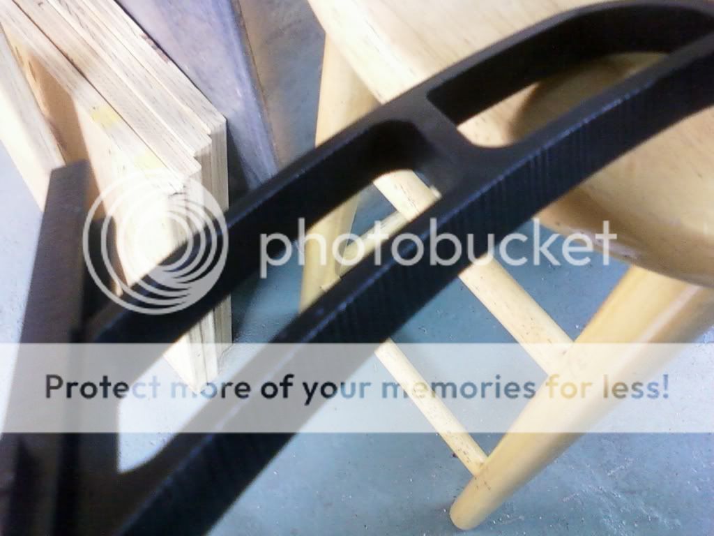

Mine showed up last night. Opened the box, eager to see this unicorn that we've all been waiting on...
...is it just mine, or is the machining on the curved sections of the legs a bit sub-par? Big chatter marks up and down the top and bottom - to the point it looks almost serrated.
The 'critical' areas all look done nicely and I'm sure it will work just fine... but for $250 I guess I expect a little better fit-n-finish all around. Debating whether to call them and send it back.
Yours looks a little better than mine. I agree that the finish could use a little work, but it does shoot well. I'm not sure the extra $50 for the vetical adjustment was worth it, but I haven't shot it on an actual mound yet - I'm relegated to concrete and plywood for now.
Talked to Sinclair this morning... apparently thats the 'finish' that all of them have. Something about the shop these are done by saying that thats just an unavoidable side-effect of cutting on a curve - which sounds somewhat hokey to me; looks more like someone has the feed rate set too high. But... I guess that its not going to get any better by sending it back for replacement, so I might as well put it thru its paces.
I will say that I am very pleased that they put scales on the legs... that was something I was wishing for on the Gen 2 but it never happened.
If you decide to keep it, take a sharpie paint pen (very fine tip, oil based paint) and paint in the marks on the legs. They can be a lttle hard to see in direct light.
