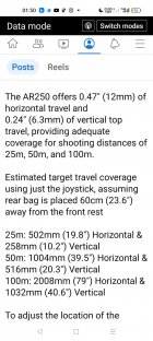

Is the additional joystick travel in windage, elevation or both?
Thx!
Ken
Especially the horizontal.
According to his calculation, I don't remember with the numbers, it will cover most air rifle and rimfire targets with some spare.
SEB,
Thank you.
FYI, the greatest elevation change is on the 100m targets (designated as the A33, is 14” wide by 44” tall). The current solution is to make a wide wedge to slide under the rear bag to be able to shoot the bottom bull.
Example:
If your son can confirm the new joystick windage and elevation ranges, it would be a benefit for shooters in deciding what specific SEB rest to purchase.
