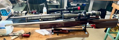

I wanted a .300 WSM but ran out of actions to build one on and did not want to spend a lot of money on it. So I did something a little silly. Pictured below is probably the only Savage Axis (Walmart Gun) rebuilt in .300 WSM. Kept the build cost very low and am now working loads for it as pictured. Go ahead laugh, I laughed too until I shot it :)
Savage axis donor - $300
Repurposed 308 take off barre - Free
Used Boyds stock off Ebay - $250
Magnum Bolt head - $30.00
Extended bolt handle -$40.00
Ebay Muzzle brake -$20.00
Arken Scope Used Ebay - $300
So the total rig cost shooting less them half MOA out the gate without load development around $1000
Moral of the story, THIS SAYS A LOT FOR 300WSM
I did all my own machine work, bedding, chambering, etc...
First time out it shot the group shown below
LOAD:
67.5gr of Staball 6.5
168gr Federal Trophy Bonded (Tactical) bullet
Rem 9 1/2 Mag primer
COL=2.850
Light crimp
LOAD:
COL=2.850
Light crimp
got me thinkin. i have all the parts except a barrel and a reamer. did you have to buy a reamer?- how long is your barrel. i have a 700 action and actually a unfired factory 5R barrel in 300 WM varmint taper. gotta measure it as i would have to cut an inch or two off to rechamber. not sure i want less than a 26 on a 300 wwm. thanks
