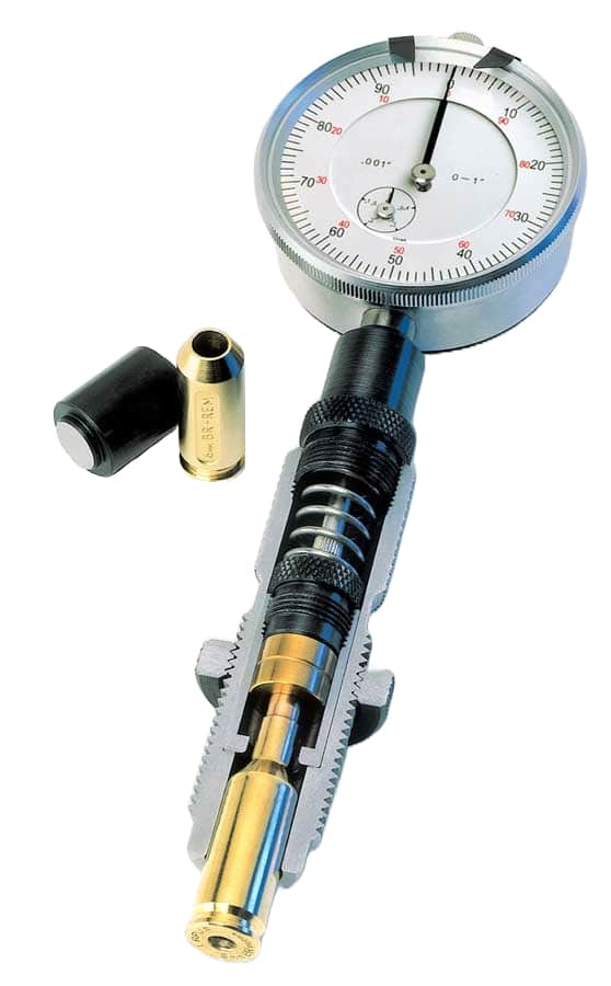

If youre struggling to use calipers, I would suggest using a tool like this;
This will take your caliper proficiency out of the equation. There are alternative tools like that on the market from different manufacturers. That one is good as you can just slowly drop your press handle, removing your variable hand pressure.
Im not sure whats finicky about the Redding comparator. You put a case in and look at the dial. Couldn't be simpler.
I haven't used that RCBS one, but it actually looks way more finicky for a beginner. It doesn't have an instant indicator. Plus it looks very slow. You have to take the case in and out every time, screw in the micrometer....
I certainly wouldn't pick that RCBS one if I wanted a fast, user proof option for a beginner.
