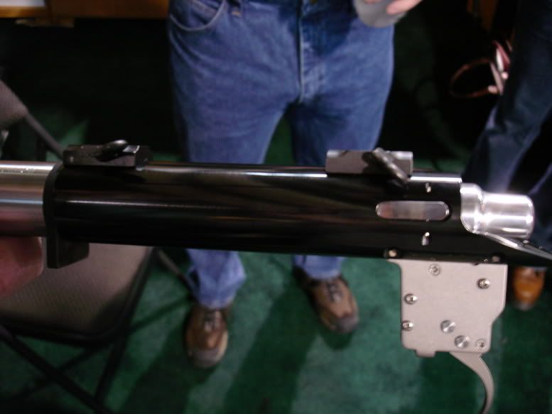

At Harrisburg last weekend I got a look at one of the first...looks like a winner, and felt like one too.
Amazingly smooth re-cocking...similar or better than the Viper and BAT's
Cro-mo for now, but SS if the demand is there.
lots of EDM work, but dont remember the full specs.
I was pretty impressed.
JB
Looks a lot like a remington reciever. Is it the same footprint? Looks light as well. Do you know what kind of clearance he has with the bolt closed? For those that need the light stuff for lightgun class, that might be just the ticket!
Chris...

Here's what I've learned:
clearence is .003
Prototypes in about one month
Right bolt Right port short action
Price around $850.00
Remington footprint
Scope bases same as Predator,two Remington front bases)
Stainless Steel is coming. When?????
I may drive down to see one in the flesh before spring.
Don't know if this answers any questions but may help.
Danny
I spoke to John this afternoon. John quoted $850.00 with a Rem extractor or $875.00 with a Sako extractor. The OD is 1.350" for a drop-in fit to a stock inletted for a Remington. The action uses a PTG,Kiff) one-piece bolt with modifications to the bolt handle/cam for improved smoothness.
I was down to John's Wedensday. We are making a rifle with one of his actions.
First, the actions look like a custom BR action. They are made to BR toerances. They will be made of chrome moly at first, stainless steel to follow if the demand is there. Jewell or other custom triggers will fit. Essentially what you have is a custom BR action with a Remington footprint.
We are using one of these actions to make a light hunting gun with a Borden Rimrock stock and #3 .22 X 14" twist barrel, 22" long. It will be chambered for .22 PPC, .100" short.
NOW, we wil also have a fat match barrel for BR shooting in the same caliber. We will have a benchrest stock so I can change barrels and stocks and shoot it in BR matches.
All I will have to do is switch barrels, move it to the BR stock and screw on a higher power scope... my 7-1/2 lb. hunting gun will become a,I hope) killer benchrest gun. Obviously the gun will be a "screw together".
We hope to have it together and shooting by the Super Shoot.
Dick Wright
