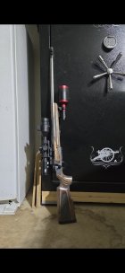

Nice shooting. Which Arken EPL is that? How do you like it so far. I have a Howa mini in 6.5 G and like it a lot. It wears a Krieger barrel and shoots phenomenal also. Now you got me interested in this wildcat.
Thanks. Epl4 4-16x44. I love it, not much more recoil than a 22.
