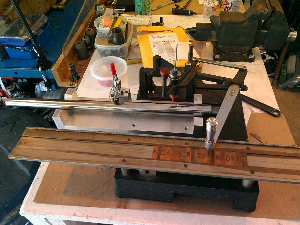

Without seeing it, hard to tell. But guessing, $300-$400 range for a tabletop version with fonts and set up to do barrels. The reason I say that is....I have about that in mine with 2 full and one partial font sets. I have a really nice single line script that does really nice job on barrels.
The downside on mine is, I need to use 3/8" sized font to make the proper size font on barrels due to a fixed arm. If I want a larger engraved font, I need a larger font. I believe mine is 2:1 fixed ratio. If the one you are looking at has a adjustable ratio arm, its worth more.
Here is mine...
I have $150 in mine. It's a manual model & came with one set of fonts.
Chuck, I'm liking your barrel vice / clamp setup ... Well done!

I can't take credit for the idea...I just copied and fit it to mine. How mine is set up, I'm able to mount the factory New Hermes vise without removing the vee block mounting system so I can do small stuff like dies and stubs. Works well...just using a diamond scribe.
Yes ... it was a Craigslist steel from a semi-local sporting goods store that was closing its doors. Took all of about 30 seconds for me to make my mind up to buy it. The fonts alone are nearly that on eBay.
Here is mine...
Chuck, what model panatagraph is this? I really like your setup - very nice work!
Does anybody know if a Green model 106 pantagraph would have enough height to use a fixture like this?
8M 4650
I could not find any info on the web about it. It was originally motorized, but don't have the motor or brackets.
