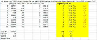

Today is the first day I got to run my new Garmin Xero and like other's have mentioned, it didn't miss a shot. I set up my MagnetoSpeed V3 the same as always and set the Garmin off to my right side ~10" and ~24" back from the muzzle. In taking 20 shots with 10 shot sessions, there was a variance from 0 - 3 fps difference (one outlier of about 6fps). Below is one of those 10 shot sessions:
