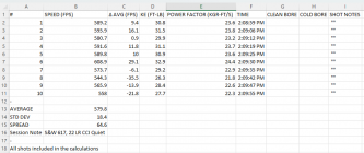

One of the things I like about my Magneto Speed is I can save the data to a spreadsheet on my PC. Does the Garmin have that capability?
In the ShotView app on phone or tablet you select the session, then there are 3 horizontal dots up in the corner. First option is "Export as CSV" (comma separated variable), at least on an Iphone, it then pulls up the option to text or email to yourself or others. When you open it on a PC, it looks like below. If you've entered a bullet weight, it would have calculated a KE and power factor. If you had entered notes for clean bore or cold bore, they would be there.
Thanks.
