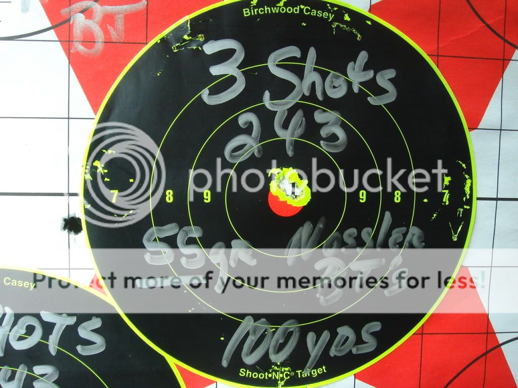

All I can tell you is I have several factory guns and several custom guns. As far as a new varmit rifle, my Savage VLP 22-250 and VLP 243 gets the job done. The 243 will shoot 1/4 groups with just about any Federal factory ammo!
Starting out and maybe on a budget, I will stick with the VLP 243. It's one good gun that shoots 55gr NBT's or 105 AMax's!!!!
I also have a Savage FCP 308 that shoot factory ammo pretty tight. I have shot it several times on our 600 yard range with factory ammo and scored pretty decent! In fact, one of my best 60 shot scores ever is with this gun and factory ammo. If I am long range deer hunting, this is the gun I bring.
All depends on your budget . . . . How much shooting are you actually going to do? If were talking around 250 per year, factory is the only way to go!
Custom rifles are nice! I have a tight neck 6.0x47 Lapua (Kreiger barrel-8 twist) that is probably my most accurate long range gun shooting 105grns! I have a Nightforce Benchrest Scope mounted on it! You can buy the Savage VLP 243 complete rifle for just about the same price as I paid for my custom 6.0x47L barrel!!!!!!! We won't get into the SSS stock, Savage PTA action, trigger, bedding, custom bolt, etc.! I don't bring this gun on any hunts! It's strickly dedicated for long range matches!
PS: I found the below Picture. My factory Savage VLP 243 Shooting Factory Federal 55gr Nossler Balistic Tips.
It shoots all Federal NBT's pretty tight!
