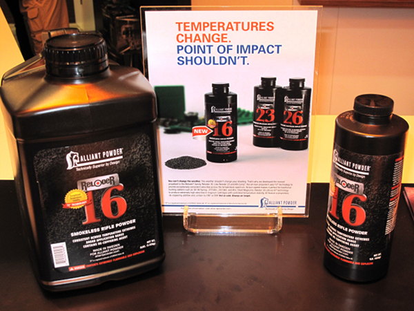

To add to your "New fangled list": Alliant is coming out with RL16 !.!.!
Donovan
Donovan, thanks for the "heads-up" on RL-16.. I just looked at the Alliant description of it and it looks GREAT! I might just get some and try it in my new Dasher with the Berger 108's! I had NO IDEA they came out with this powder. Thanks again!!

So now, in the burn rates that I use, I will have RL15, 16, 17, 19, 22, 23, 25, 26, and 33!!
WOW!!

Per Ed Dillon,
RL-16 is IN the newest update for QL along with several new bullets/powders etc.
Waiting for my copy to get here.
