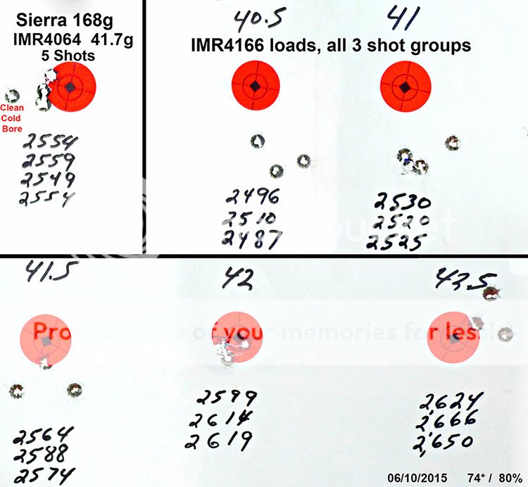

I usually use Varget or IMR4064 in my .308 The IMR4064 is a bit more accurate but also is more prone to temperature variations. I bought a pound of IMR4166. I could not work up a load that shot consistently well with it and gave up. I used 168g Hornady BTHP Match bullets in Lapua cases. The jump was set to .025". At 42.0 grains, I chronographed them between 2,599 to 2,620 fps in a 22" barrel. Of course each rifle is different, yours may like it.

I found an old target when I was trying the 4166 powder. These are all (.308) 168 grain Hornady BTHP Match bullets in Lapua brass. I shot 5 with 4064 first and the rest were with 4166. The 1st shot was off because I just cleaned and de-coppered the barrel and it was a cold bore. The rest of the 4064 grouped a little better. The velocities are about the same but maybe slightly higher for the 4166 with the same load.
Mistake, I see I used 168 grain Sierra Match Kings for all these, not the Hornady.
