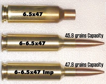

Not familiar with a "long Dasher" does anyone have a drawing of one by chance?
Thanks
Bill Bowers
Bill the Long Dasher is based on the 6.5x47 Lapua, It has a 40D shoulder instead of a 30D. It also has less case taper and games about 2gr of capacity or about 150fps over the standard 6x47. Here is a drawing and photo.
