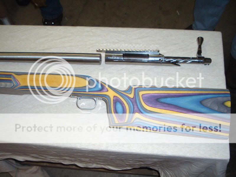

Short action Defiance Rebel.
Single shot.
RBLP.
3 Trigger hangers.
20 MOA rail
Long Tennon.
Heavy Tang.
Chambered up for the 6.5x47L for 1000 yard VBR at Ridgway,Pa.
With STP and TSI-301 as a bolt lube.
There are the slickest fuctioning rifle actions ive ever been around.
