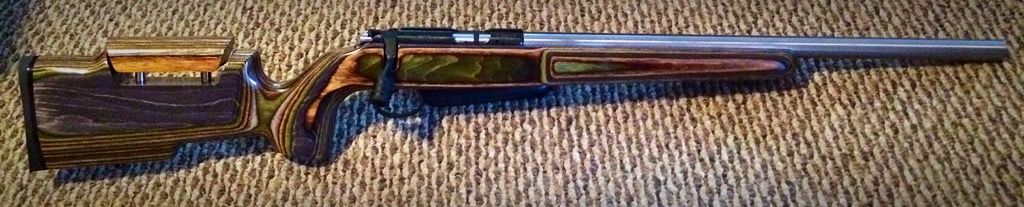

Here's mine

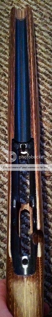

Pillars added and epoxy bedded
Yodave trigger kit
Started breaking and first ammo testing. Likes all RWS 0.5"/1"/1.5-2" at 50/100/200 meters.

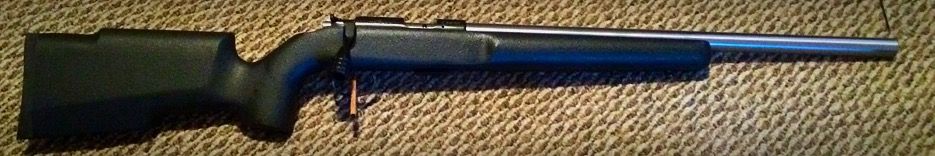

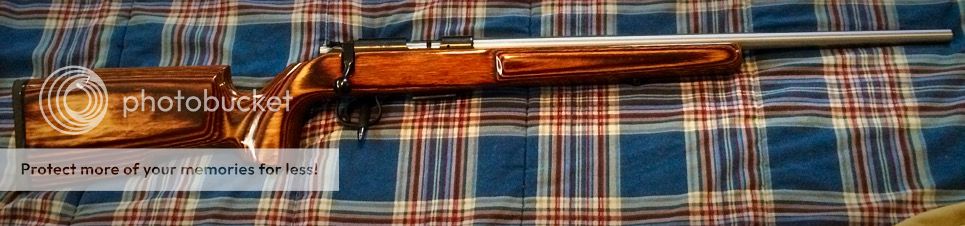

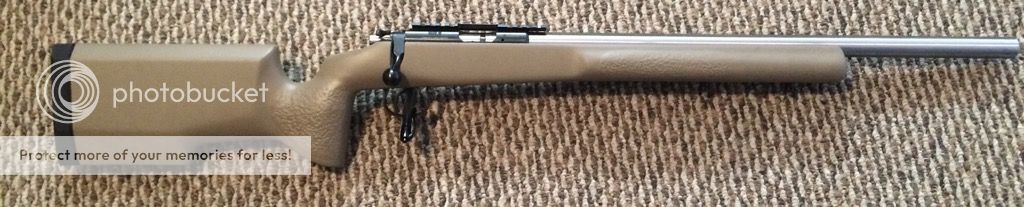

All of the ones pictured are actually full length bedded but by fully bedded I meant pillars and glass bedded. 95% of the 455's will shoot excellent full length bedded but some will prefer to be free floated. Soon I'm gonna try gluing the lilja barrel in place and will bed the entire action area and just an inch of the channel. I'm curious to see if this will improve anything. Here are some pics of 455 stocks I've done full length bedded.
