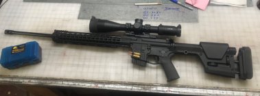

New Build: 22 ARC AR15 Platform (gas)
I shoot targets, no game. Targets in yards: 100, 150, 200, 250, 300, 350, 400, 600
I've ordered parts for a new build and loading.
22 ARC barrel from X-Caliber, 24" Bull 1:10 twist rate
RCBS full length sizing die and seating combo
Hornady V-Max 40gr and 50gr
Powder Hodgdon BLC2
Loading data that I can find only goes as light as 53-55gr in a 7:1 twist, so some experimentation is on the table
I also have H335 and X-Terminator on hand
I am no-longer new to reloading, but I do not have the experience of many of the veteran reloaders on this forum
So, any tips or suggestions are welcome.
I will post results when the rifle is assembled and answer any questions along the way.
Thanks!
