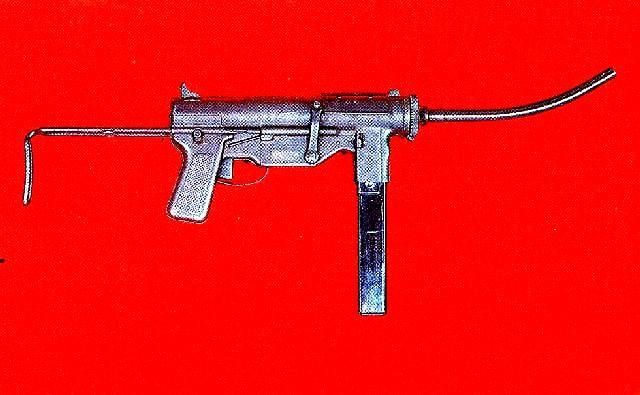

FWIW - if it comes back looking like this, next time pay the smith a little more:
Isn't that for shooting around corners? Matt
