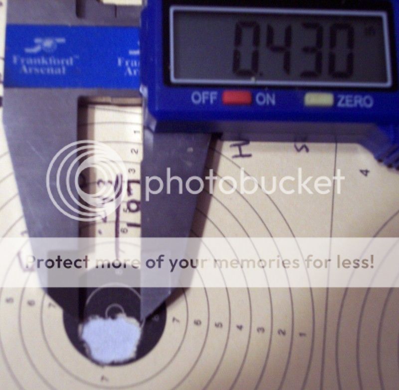

ok somebody with ontarget want to measure the group,,it is a 5 Meter 4P BB gun target,,the black bulls are .725,,

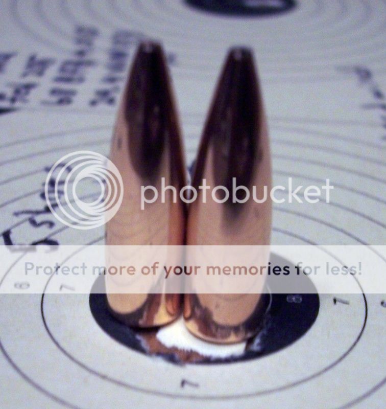

I tried to get a pic with two 68 Berger FB bullets and they like a right smart going in the hole side by side,
the hole measures .430 outside to outside,,but I did measure one of the single holes and it measure .239 so you can add .004 to the group .430-.239 =.201
if two .243 bullets wont fit the hole it has to be less than .243 group,no??
