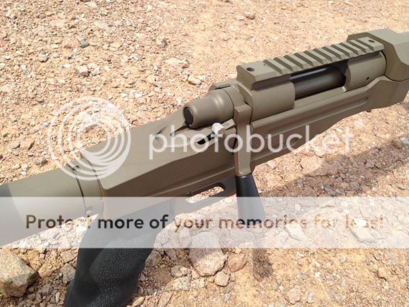

Today was finally new rifle day for my 6BR. It was purpose built as a midrange target rifle. Donor rifle was a .308 SPS Tac. Ordered the reamer and go/nogo gages from PTG in February. Got on the list with Beanland in April and got all the parts to him 1st of June. First impressions are that I think I'm going to like the XLR stock and the trigger timing is exceptional. The LR Accuracy bipod is sweet. Specs as follows.
All work done by Jon Beanland
Rem 700 action trued / PTG lug pinned
Bushed for small firing pin
Timed Jewell HVR Trigger/ tuned cocking piece
XLR Chassis / Rear tang bedded
Long Range Accuracy Bipod
6mm 10 twist Krieger barrel finished at 24"
Chambered in 6mm BR Norma (.2704 neck/.089 freebore)
Kampfeld Sideport Brake
Cerakote finish Patriot Brown/Black
Tab Gear sling
Zee Rings
Nightforce
Load development to follow this coming weekend. Will be trying Berger 90 grain BT, 90 grain Lapua Scenar, and 95 FB BIBs.
Still need to move the front sling mount and put the offset inserts in the Zee rings for a little more clearance. Any other suggestions?

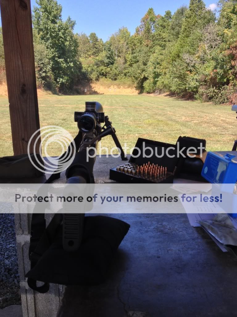

Got out today to do some testing. I shot 25 rounds of Berger 90 BT and 25 of the 90 Scenars. All with CCI450s and Varget. These were 4 shot groups and there was one oddball just checking pressure. The Bergers did best by a little bit but I did shoot them first and may have been getting tired. Also somehow got out of sink with the scenar target. The last two groups with the scenars opened up to around a half inch or so and was the worst of the bunch. Will keep testing but am happy at this point and looks promising.
Suggest that you "round robin" among your loads to avoid fatigue, wind changes, etc biasing your results.
Thanks and I do agree. Probably had more going on than I should have doing tests with two different bullets at once. I think the Scenars will shoot about the same as the Bergers at these weights, and did all but the last two and I'm not giving up on them by a long shot. Also there were no signs of pressure so it looks like I can go up some more in further testing.
One interesting thing with my particular lots of bullets though. The Scenars were actually larger in diameter than the Bergers. Just very minute but showed a difference of 10 indicator reading on my K&M arbor press and was very consistent between all loaded.
Higher seating pressure doesn't necessarily mean a larger bullet. It could have a longer bearing surface.
