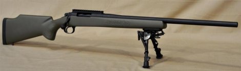

Hey guys,
Just got a GA Precision 6.5x47.
It's a single shot templar action, 24in bartlien barrel, manners stock. 1in8 twist.
I'm thinking I will start with some Lapua and Sierra 123's and some varget.
What primers are you guys using and anyone have any starting suggestions for a load? I know each rifle is different but just to get an ideal.
