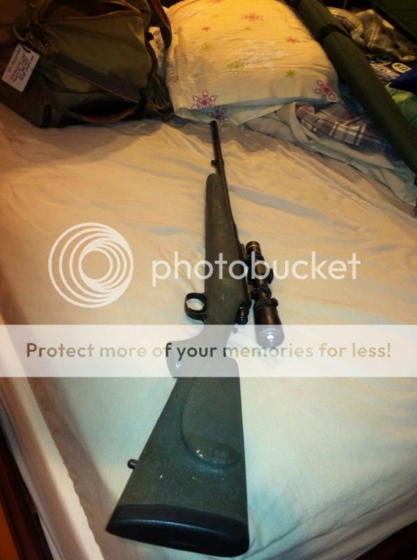

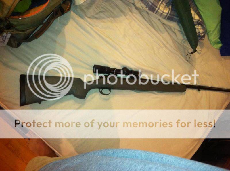

I acquired a new Remington 700 in .375 H&H that was built by a guy named Frank Wells out of AZ. My dad picked it up in an estate sale and didn't really need/want it so I got it from him. It has a Douglas sporter barrel, action was blue printed and trued by Frank Wells, polished factory trigger, McMillan Mtn. Rifle stock, and a Leupold VXIII 1.5-5x20. I am looking to do some reloading for it start with some 250gr. Game Kings but thought I would pull from the wisdom here first. If you have any load work that you'd be willing to share, please let me know. I have only loaded up to my 7mag so am not sure on the bigger caliber stuff. Thanks a ton!

I just acquired the rifle and haven't gotten to play with it much. Not super interested in selling her right now but if you had a real serious offer, PM me and I will talk with my father about it since I just got it from him. Thanks for all the info guys!
