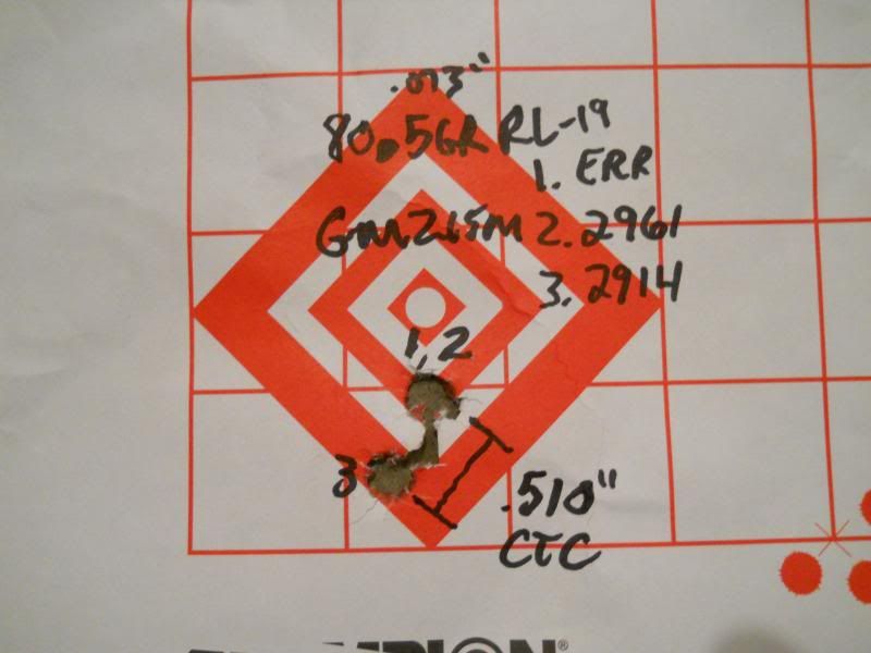

RL-19 almost had a "robin hood" group ata round 2960 fps, but the last round went haywire and dropped over 50 fps from the other two rounds in the group making it a .510" CTC group. Don't know what happened there? Rounds can start doing weird things when pushed to the upper limits of pressure.

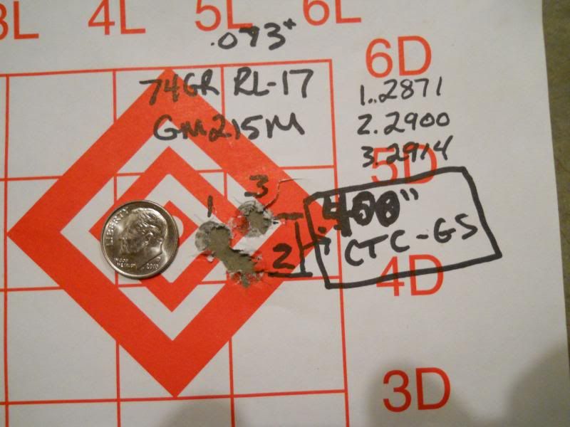

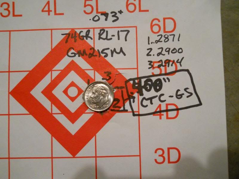

RL-17 group pics. 1)Group next to dime. 2)Group covered by dime. Formed a beautiful triangle shaped group with no fliers. Not too bad when you can cover three 338 cal bullet holes with a dime :)
RL-19 Group. Notice the haywire speed on the 3rd round and how it hit lower than the first two.

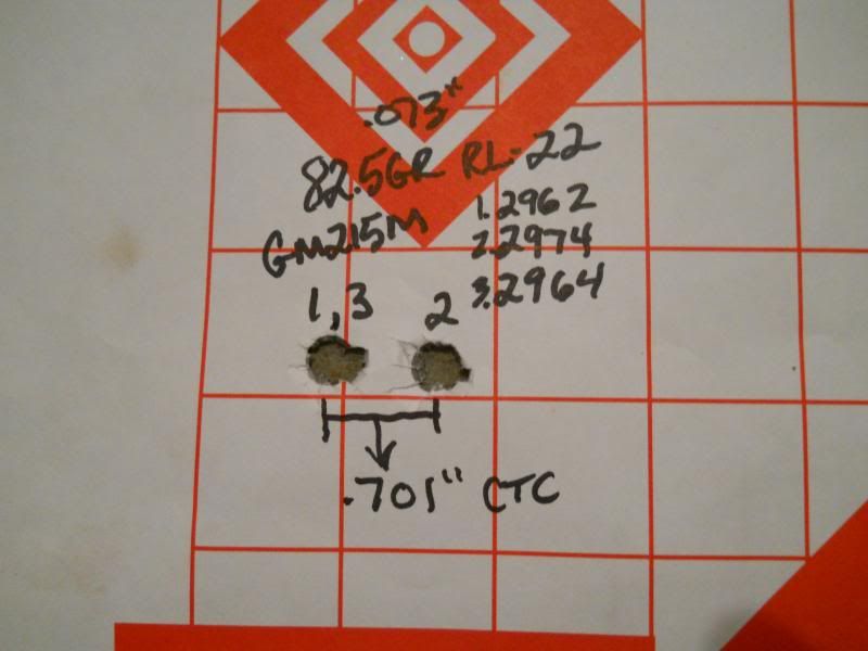

RL-22 with 1/2gr increase in charge from last test. Don't like the 2 and one groups at all. Last group showed that same pattern and accuracy is getting worse with increased charges.

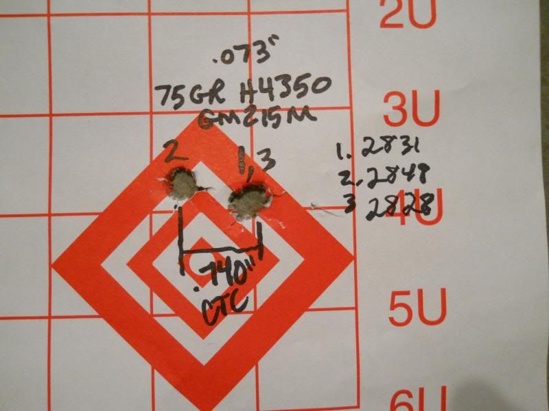

H4350 group. Not bad, but I think I'm just gonna let this one lye because of the 2 and 1 flier pattern.

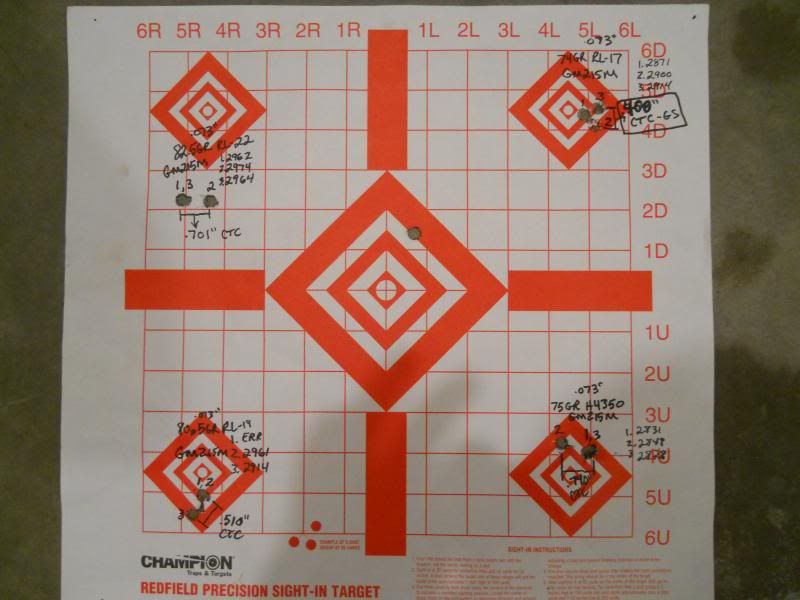

All groups together.
