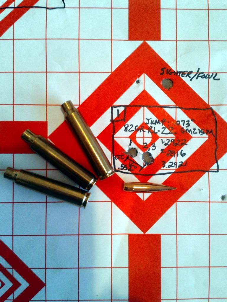

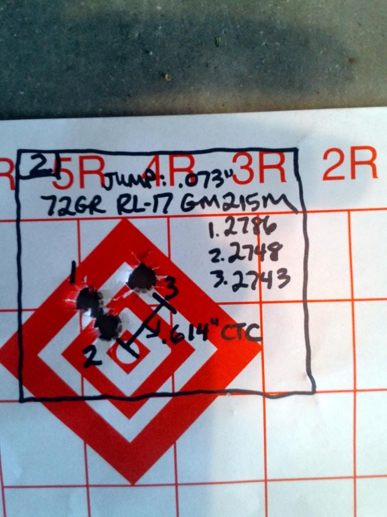

Below are photos of the two 3 shot groups I was able to get off today. She shows a lot of promise. Have three more 3 shot groups to do tomorrow and break-in will be complete. This thing is definitely gonna be a hard hittin' tack driver when I get done with it.
Groups are fired with .073" jump to the lands so they fit in my magazine and GM215M primers. Grid squares on target are 1". Chronograph was set all the way out to 20 ft in front of the muzzle to avoid any muzzle blast interference.
82gr RL-22 / 2920fps / .552" CTC greatest spread
72gr RL - 17 / 2750 fps / .614" CTC greatest spread
The two groups are respectable and plenty good enough for hunting, but I like sub 1/2 MOA or better with any modern bolt rifle I own, so we're definitely not done. But considering the circumstances, the groups are very good.
By circumstances I mean;
1. Enormous amount of recoil, so you really have to hold onto her tight which wiggles the reticle a little bit on 30X.
2. Brass shoulders are fire-forming during these tests.
4. Necks are not turned because they need to fire-form first.
3. Barrel is completely cleaned before each group, with only one fouling shot before each group. Then let barrel fully cool, and fire 3 shots for group in quick succession.
The RL22 group was very nice and shows great speed potential with about a 2920 fps avg. The RL17 was loaded extremely safe because I am creating this load myself from burn rate charts. I will increase it's speed gradually in future load testing. Neither load showed any signs of pressure on the brass, so I think 3000 fps is definitely within reach.
And to think, all that speed and only from a 26" barrel that can be shot without a brake and in a standard length action....Look out 338 Lapua, little brother is hittin' the gym he's right on your tail ;)

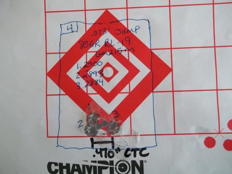

Got my last 3 groups shot today.
RL-19 shot very well, but could use a bump in speed. Group was .470" CTC. Picture below.

80gr RL-19, 2890 fps, .470" CTC (wood on backer was blowing out paper so I had to tape it back together)
After my first 5 load tests during break-in/fire forming, the verdict for test powders is RL-17, RL-19, and RL-22.
