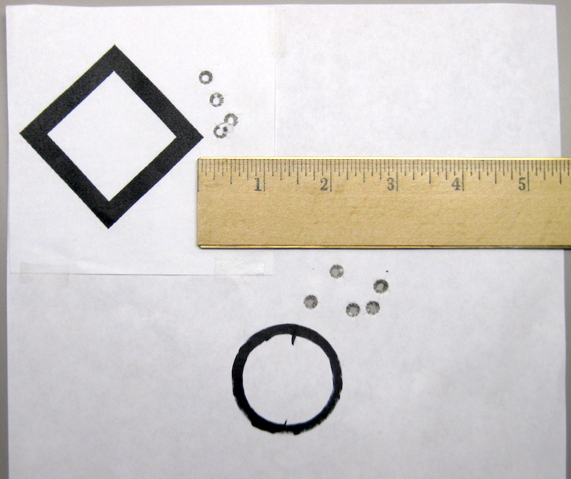

I threw this load together to test and came up with this:
.224 88 ELD-M
3298fps using Reloder 26
26" 1:8 twist (1.40 stability factor per Berger's calculator)
Drop seems to jive with Factory G7 BC out to 950 yards.
200 yards prone with a bipod/rear bag.
5 shots upper left, 6 in the middle.
