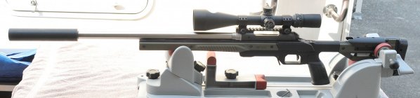

This is the 22 Creedmoor I have been working on for the last several weeks. The barrel is a 26" from Brad at Urbanrifleman, a Kauger CRS action, Tiggertech Primary trigger, Vortex Strike Eagle 5-25x56 FFP optic and a KRG Bravo chassis. I just had a chance to fire it today with some different loads I had loaded for it and I am very pleased with how it performed. Brad has been extremely helpful during this process with the hundreds of questions I have had. I have actually purchased a 6br barrel from him as well and waiting on my action from Kauger right now. I will post some pics of it one it is finished.

That stock is nice.
How are you loving that Kauger?
Let’s see some groups! Good looking rifle

Awesome group! 22 creed seems to be a win
