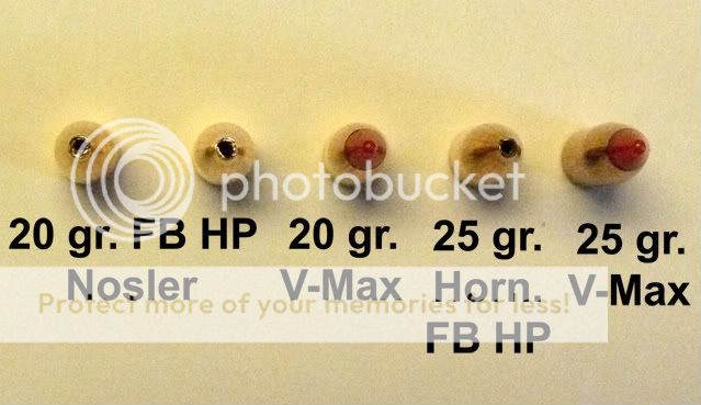

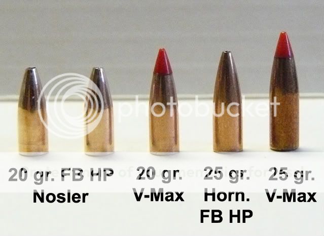

A friend of mine from Oregon was at the Nosler 2nds Store last week and noticed some 20 gr. HP .172 caliber seconds available. He picked up a couple packages and shipped them to me. Here are a couple photos of them alongside the 20 gr. V-Max, 25 gr. Hornady HP, and 25 gr. V-Max. The 20 gr. bullets are around .493" long--base to tip. On my Stoney Point comparator they measured from .247" on up to .260" from the base to the ogive. Weights of these 20 gr. bullets varied from 19.82 on up to 20.02 gr.
The first two bullets in each photo are both the 20 gr. Nosler FB HP bullets. The one on the extreme left did not have any lead in it!!! It weighed in at 6.94 grains!!! They WERE labeled as seconds, but I didn't think there would be any bullets without lead in them???? :eek: :eek: I will definitely weigh all of these bullets before reloading any of them.
Side view. The dark tip that appears on the bullets is the reflection of the top of my table on the sides of the bullets. The bullets DO NOT have dark tips--SORRY!!!
Top view:
There is some material partially closing the tips on some of the bullet, but I think they will open up quite nicely when they hit gophers and prairie dogs.
