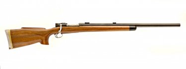

I have another ‘06 I want to shoot and I’ll use the 125 grain bullets for that one too. It’s an old gun I picked up from Gary in Florida. It’s a Model 30 Express barreled action in a custom stock and set triggers.IMG_1988.jpegIMG_1989.jpeg

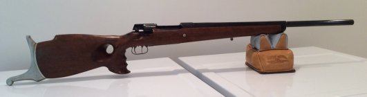

Here's a match rifle that's been in my collection.
The trigger looks to be hand made. Chambered in .250 Savage with "Mann Chamber". I'm not sure what Mann chambers were like. I've read he was interested in zero neck clearance, which is a little scary, but I'm not sure what that means in this example.
