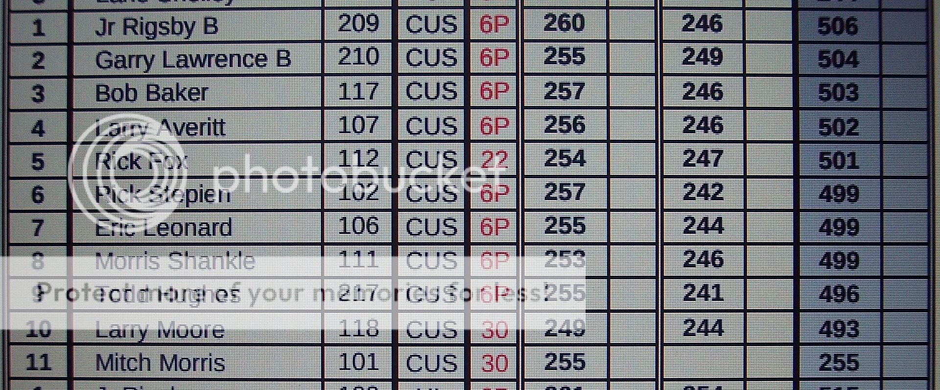

I shot a 499 today on the new bbl that had 70 rounds on it this morning and using mostly brass that hadnt been shot in it yet,,
bbl now is at 200 rounds and brass should be ready to go,,
remember also that before March of this year I had never shot a match or own any wind flags,,my main goal for this season was to learn the game and shoot a 500 so I am tickled to death and having a ball so far,,

Looks like you shot a good score in some rough company. Congrats to you. They're all good fellows, but show you no mercy in competition. :D:D
