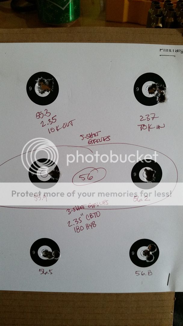

So, that being said...here are the results from the testing this AM at 100 yards.
Top two groups were all 5-shot groups, one is 10K out and one is 10K in, with 55.3 gr H4831SC and 180gr hybrids out of a 30" Brux barrel for the 284 Shehane. The 55.3 gr group was the one with all 5 brass turned, although this was the load I settled on from previous outings as being the best load so it might not be a fair comparison and the top right group for fun, shot a 5 shot group 10K in the lands to see if there was any change to the group size.
Now, the bottom 4 groups was a different barrel, 32" bartlein, same caliber, different gun. I shot a previous load work up all the way from 54.8-55.6, but saw some signs that I might be approaching a node beyond 55.6, so this week I loaded up 55.6, 55.9, 56.2, 56.5 and 56.8 gr of H4831SC, all 10K off the lands and 180gr hybrids. Sure enough, I was right and it looks like around 55.9-56.5, there seems to be a good node there. These were 3-shot groups. I will be going out tomorrow at 200 which is the farthest I have near me and see how this node does for 5-shot groups at 200. All bottom 4 groups were done with brass that require a little more effort to close the bolt, but not to the point where I was worried about it. Obviously, it doesn't look like it affected my groups all that much ;)
Bottomline, here is what I got out of the feedback...I will proceed with caution on neckturning brass with a high round count and will most likely just retire the brass, I am considering actually getting a custom die with a neck honed to the exact dimension I want so it sizes all of the neck and not just a portion of the neck, neck turn the brass to begin with or start using something like the 284 Norma brass so I am not fighting donuts as much in the future, possibly switch to a two part process of finishing the necks with a mandrel to obtain more consistent neck tension, and most importantly.....sometimes we can do all this testing of theory and in the end, the shots on paper go against what you thought would happen prior to shooting it, just make us question more what the right answer is. LOL.
