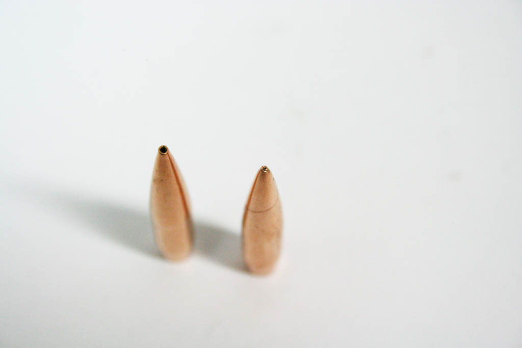

Barry, what punch are you using for the Hybrids? I am using the same one I used to tip my 105 VLD's, which is B-12. I should order a B-2 and see if there is any difference in tip contour.
I'll try and take a couple pics of what the B-12 produces. The only reason I am using it is because I had it on hand, LOL

Here is what my B-12 is doing...
$50 per pop is pretty expensive to experiment...that is why I did not buy another yet!
105 Hybrid, unpointed on left, pointed on right
