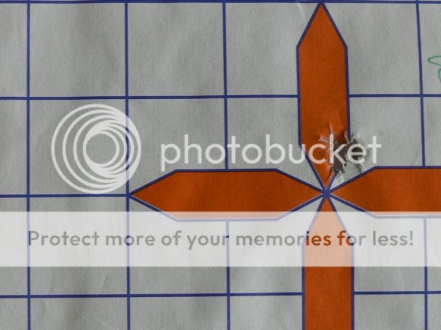

Fired in a 1-9 twist Savage. (with the factory HEAVY trigger)
jbpmidas said:
7 twist Savage
Lapua brass
24.2 Varget
80.5 Berger Fullbore
FGMM primer
Just shot some 80.5 Berger full bores for the first time Friday.
26" 1:7 Benchmark 3-Groove
24.4 gr varget
Lapua Match Brass
BR-4 primers
Just took the Sierra "accuracy load" as a starting point and was able to shoot 5, 5 shot groups at 100 yards all measuring .240"-.310".
Should be able to adjust that load for even better groups but not bad for a SWAG.
