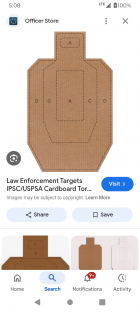

I have a S&W 586. When first purchased it, the highest I could shoot was 14" to 16" low, off a bench with sandbags. I called the dealer and he said to replace the rear sight blade to the other size. I called Smith and they sent the one I needed. Some competitions level off the sights on the shoulders. The X is down below in the center of the torso.
Good luck
