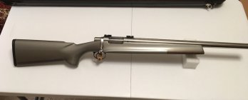

I'm needing a rear bag that fits my stock better than the one I have now. Here is the pic of my rifles buttstock if that help...
I noticed most of the benchrest guys have flat bottom butt stocks

Protektor has what you need. If you want to spend some bucks go with Edgewood. Just my two cents. Tommy Mc

Protecktor made mine to my spec's and its perfect.
Call them up....there a pleasure to work with...and fast shipping too.

FWIW I have that stock on a Superior and I have a Protector leather with little bunny ears. It works fine. I do not compete so take that into account. Call them, they will set you up
Get the bumble bee that matches the slight angle of your stock. A tight stitch and short to medium bunny ears.

Mine is also a Hall in 6PPC. The stock looks identical but someone decided it needed to be purple. its glued in so i haven't done anything to see about painting it, but it needs it. Mine has the same scope bases, Z rings and a leupold 36 power on it.
Just looking at the picture, it appears there is more sand in one ear than the other. Before buying another rear bag, it may help to play around with the amount of sand in each ear in order to balance the spacing out and have the rifle sit squarely within the ears. Rear bags can be ordered with different spacing between the ears, i. e. 1/2 inch, 3/4 inch, 1 inch, etc. If the above doesn't help, measure the stock and order the appropriate spacing.

Protector or Edgewood either one will give you great advice on ear height and the space between the ears to fit your stock. I agree with the other poster that it appears that you have too much sand in one of the ears and maybe too tall ears on that bag. But one of the bag companies will help you for sure. JME. WD
